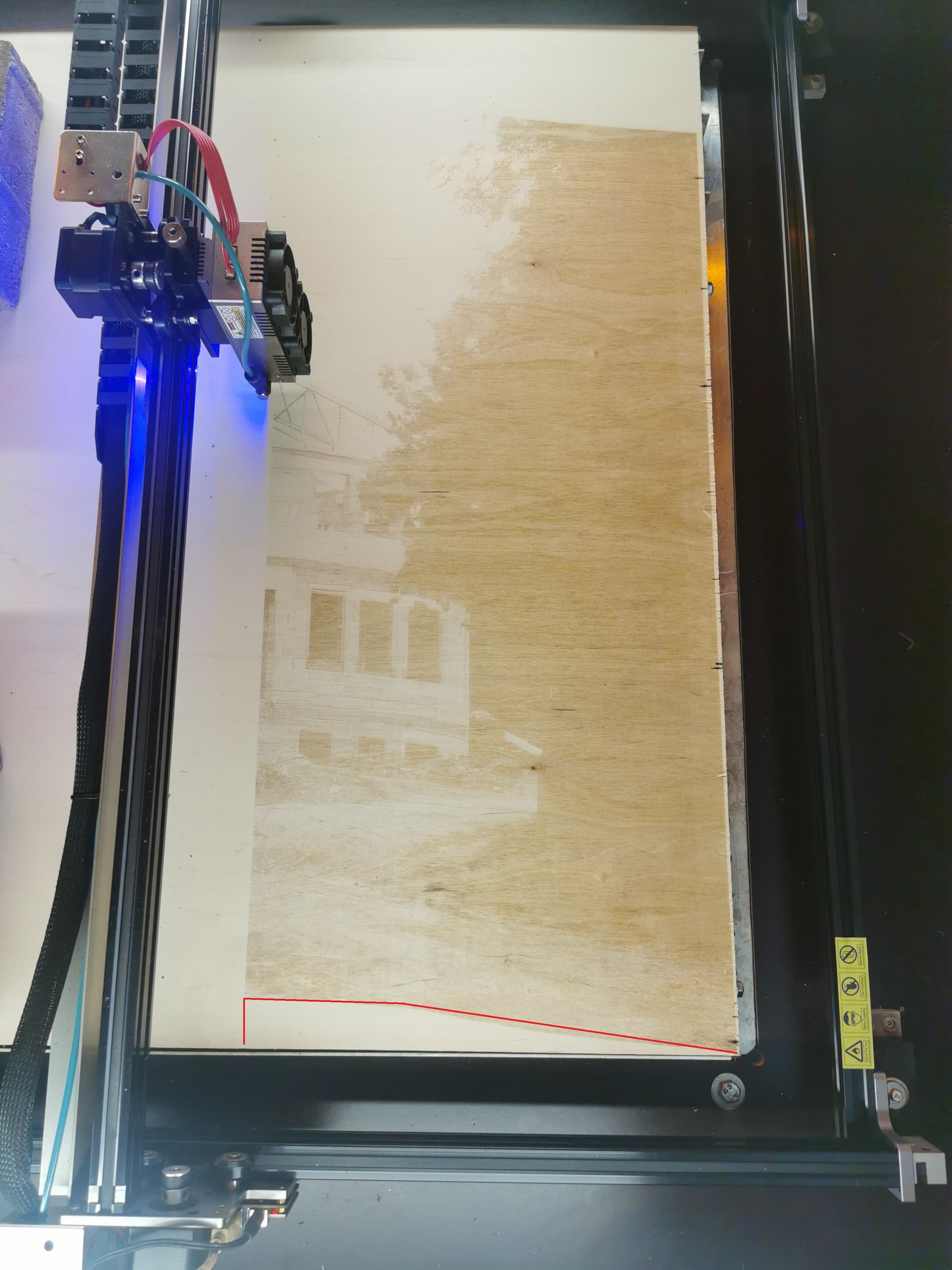

The scanned image will be offset, and you will get a tilted work (note the red line in the picture below)

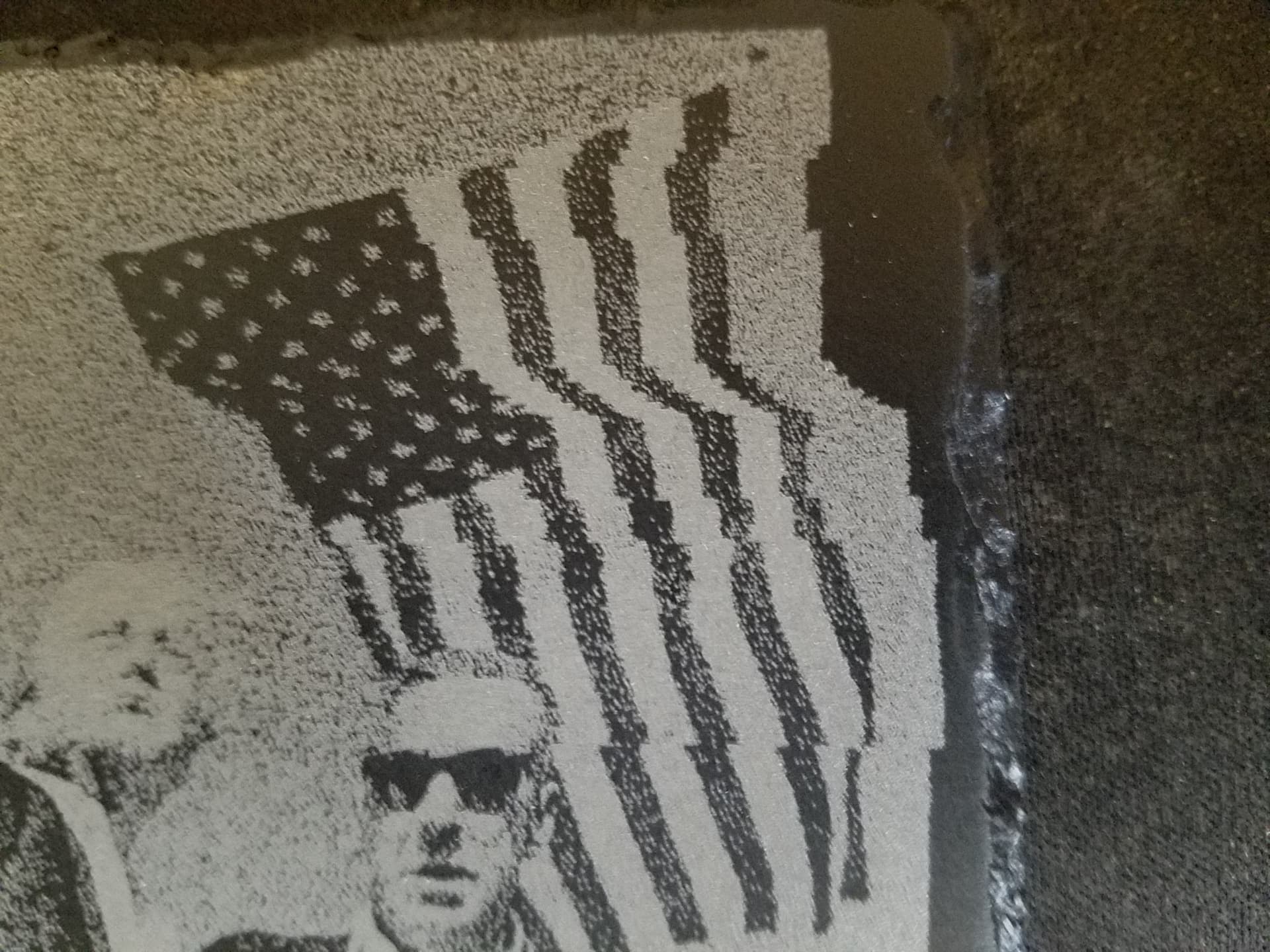

The scanned image is misaligned, as shown below
The cause of this problem is that we used the wrong synchronous wheel accessories.

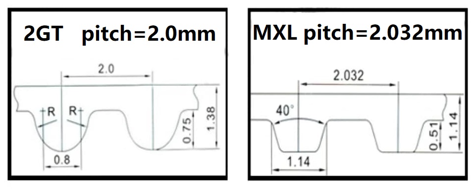

There are two types of synchronous wheels: 2GT and MXL. The 2GT synchronous wheel has arc teeth, and the MXL synchronous wheel has rectangular teeth.
Similarly, belts are divided into 2GT and MXL types.
2GT belts need to be used with 2GT wheels.
MXL wheels need to be used with MXL wheels.
If the wheels and belt models do not match, problems will occur.

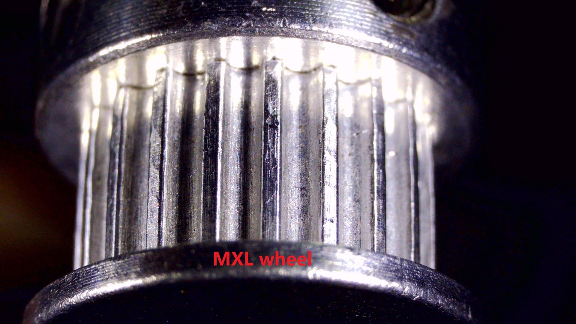

You can also remove your synchro wheel and check the shape of the synchro wheel teeth. If it is round, it is normal. If it is square, it is abnormal.
