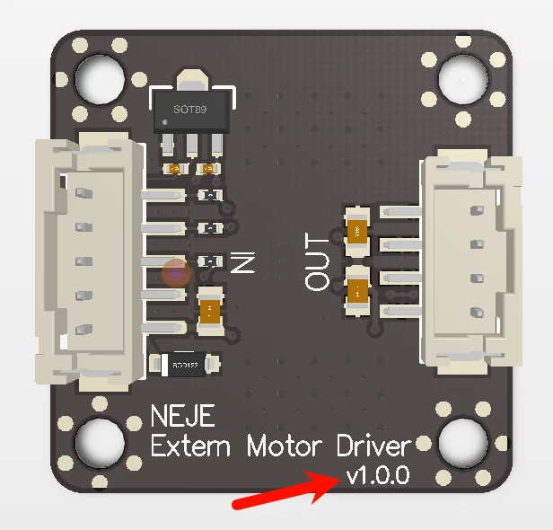

Please check your expansion motor driver board version, the version number is marked on the front of the circuit board
If your rotary motor driver board version is v1.0.0
Please contact us by posting on the forum.
Please include a photo of the version number of your motor driver board in your post.
