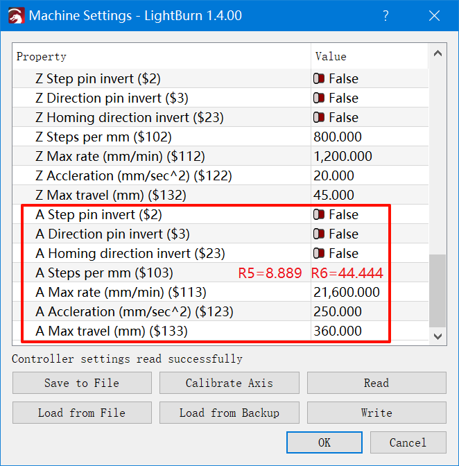

For control boards with A-axis extension port, such as NEJE Max series devices, it is recommended to use the A-axis extension port to connect the rotary axis.
If the A-axis extension port is used to drive the rotary axis motor, an external stepper motor driver is required (usually installed on the R5 rotary axis). You only need to connect the signal input terminal (5 Pin) of the external stepper motor driver to the A-axis extension port of the control board to complete the connection.

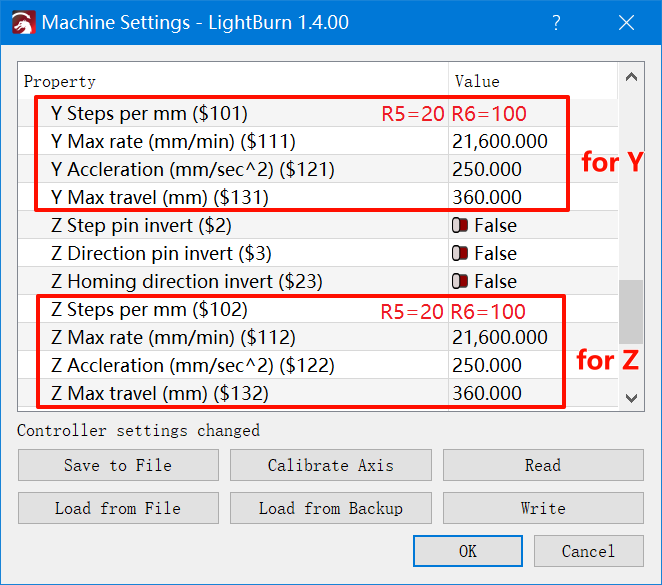

For NEJE 3/4/5 devices, it is recommended to use the Z-axis to connect the rotary axis assembly.
If the Z extension port is used to drive the rotary axis motor, an external stepper motor driver is required (usually installed on the R5 rotary axis). You only need to connect the signal input terminal (5 Pin) of the external stepper motor driver to the Z-axis extension port of the control board to complete the connection.
This connection way is only applicable to NEJE 1/2/2S series devices, because this model of device does not have Z-axis and A-axis extension port.
Because the Y-axis of the control board has a built-in stepper motor driver, you only need to connect the Y-axis output port of the control board to the rotary axis stepper motor to complete the connection.

First, measure the engraving object, assuming that the workpiece to be processed is an object with a diameter of 45mm.
The following method will assume that the diameter of the workpiece is 45mm for explanation.
First connect to the LightBurn software.
LightBurn Menu => Laser Tool => Rotary Setup
LightBurn Menu => Tool => Machine Settings => Outputs setup (Make sure the red box is exactly the same)
After the above settings, your rotation axis should be usable, but it is not in the best condition. If you want your rotation axis to work with the best accuracy, please refer to:
【For R5】
Do a calculation: step = 3200 / circumference(141.37) = 22.635
If you use Y, please set $101 = 22.635
If you use Z, please set $102 = 22.635
【For R6】
Do a calculation: step = 16000 / circumference(141.37) = 113.178
If you use Y, please set $101 = 113.178
If you use Z, please set $102 = 113.178
Just like below:(assume you are using R5)
Why?
Setting mm per rotation to be consistent with Circumference can provide precise speed control, otherwise your LightBurn speed will deviate during actual work, and the work results will be different in depth.
Of course, if the mm per rotation parameter is not much different from Circumference, this effect can be ignored.
Please always keep mm per rotation * ($101 or $102) = 3200 (change 3200 to 16000 when you are using R6). If this requirement is not met, it will cause length problems. For example, when processing a 5mm straight line, you may get a 6mm straight line.
